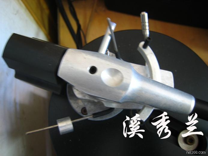

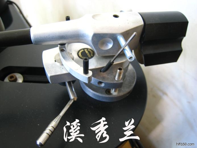

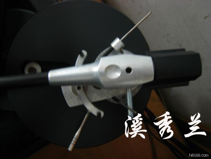

“诺丁汉”12英寸单点碳纤维唱臂,Goldring  1041动磁(MM)唱头,唱头自重6.5g,针压1.75g。

这唱臂的重陀处在不同的位置,声音差别不小,怎样才是正确的?

说明书上是这样写的:
Tighten the two grub screws in the arm pillar. Align the cartridge and playing-weight
in the usual way. When using scales, place them directly onto the mat, not on the
record. The adjustment of the playing-weight is set by moving the heavy bronze
inner-weight. The bias is set by ear, but a rought guide is to lower the arm onto
the runoutgroove of the record. It should stabilize before running gently into the
center of the record. If the stylus moves quickly to the inside or outside of the
record, the bias needs to be increased or decreased.
这个重铊是调整偏压大小的,应该调整到声音不偏两边为准,可用测试碟的“粉红噪声”段来调试...
