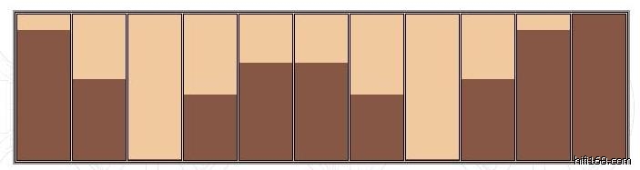

自己设计制作了三块二次余数扩散板,今天完成了,看了真美!发来分享!
(59.46 K)
2008/6/29 14:58:55

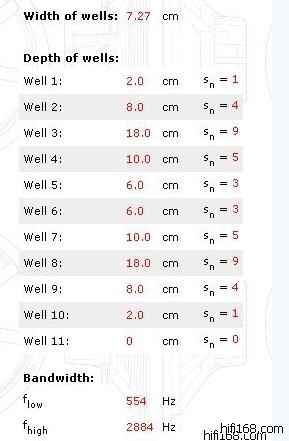

理论计算:11格,总宽80CM,最大深度18CM,成品外形160X80X20,计算扩散频率范围为554HZ----2884HZ.
(30.05 K)
2008/6/29 14:58:55
设计断面示意.
难忘的战斗 最后编辑于 2008-06-29 14:58:54

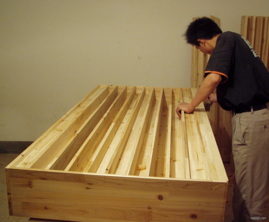

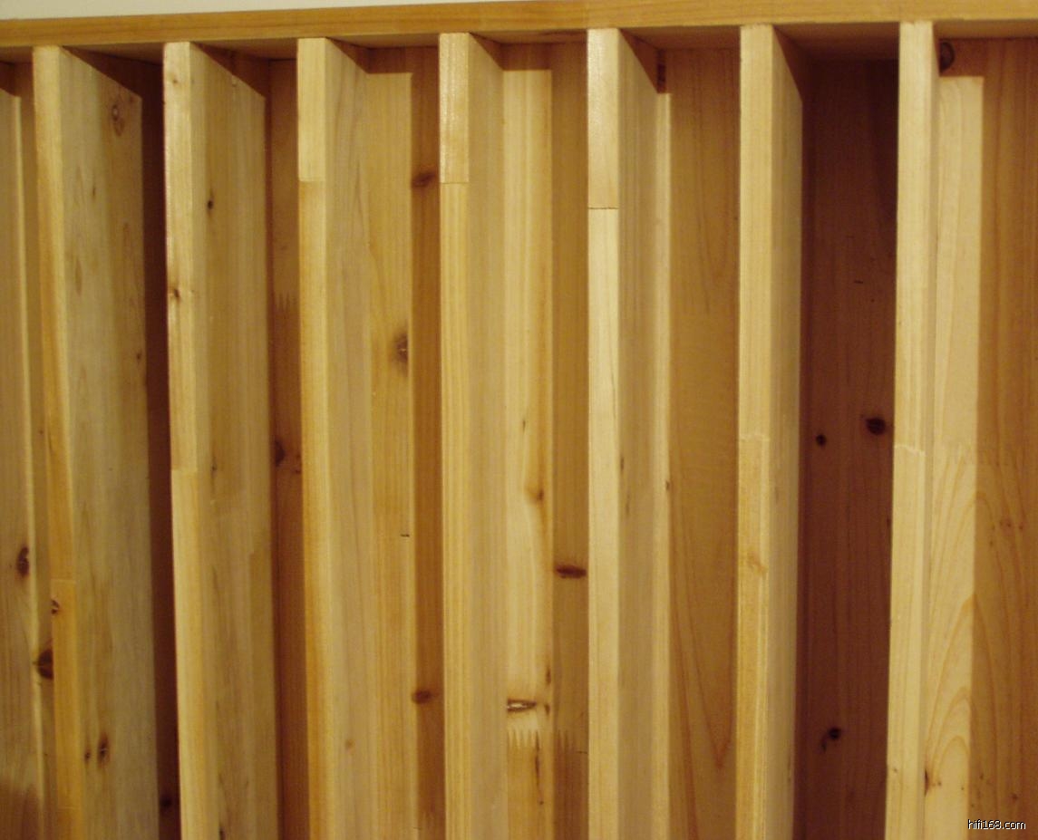

制作过程,看到断面,无后背板设计

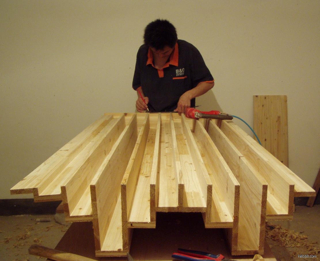

(301.10 K)
2008/6/26 19:33:34
(306.33 K)
2008/6/26 19:33:34
(339.49 K)
2008/6/26 19:33:34

全部成本:600元/块

我也用公式算了一算,同样的尺寸,数据上好像有点差异,供楼主参考,63英寸高,well width2.86英寸 最深为15.75英寸,
影响的频段从214Hz-3146Hz,只能用英寸计算,麻烦转换一下,以下为详细尺寸,
See Program Help Files for interpretation
Well Number 0 WellDepth = 0 inches
Proportionality Factor = 0
Well Number 1 WellDepth = .875 inches
Proportionality Factor = 1
Well Number 2 WellDepth = 3.5 inches
Proportionality Factor = 4
Well Number 3 WellDepth = 7.875 inches
Proportionality Factor = 9
Well Number 4 WellDepth = 14 inches
Proportionality Factor = 16
Well Number 5 WellDepth = 1.75 inches
Proportionality Factor = 2
Well Number 6 WellDepth = 11.375 inches
Proportionality Factor = 13
Well Number 7 WellDepth = 2.625 inches
Proportionality Factor = 3
Well Number 8 WellDepth = 15.75 inches
Proportionality Factor = 18
Well Number 9 WellDepth = 10.5 inches
Proportionality Factor = 12
Well Number 10 WellDepth = 7 inches
Proportionality Factor = 8
Well Number 11 WellDepth = 5.25 inches
Proportionality Factor = 6
Well Number 12 WellDepth = 5.25 inches
Well Number 13 WellDepth = 7 inches
Well Number 14 WellDepth = 10.5 inches
Well Number 15 WellDepth = 15.75 inches
Well Number 16 WellDepth = 2.625 inches
Well Number 17 WellDepth = 11.375 inches
Well Number 18 WellDepth = 1.75 inches
Well Number 19 WellDepth = 14 inches
Well Number 20 WellDepth = 7.875 inches
Well Number 21 WellDepth = 3.5 inches
Well Number 22 WellDepth = .875 inches
Well Number 23 WellDepth = 0 inches
Diffuser Depth = 15.75 inches
Diffuser Width (= Height) = 63 inches
Well Width = 2.8 inches
