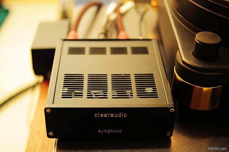

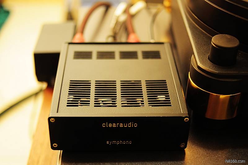

The Clearaudio Symphono (Old version, Black) is about $1,200.00 list price. It is a Solid-state Opamp phono stage and has 60dB of gain in MC only mode. With >65dB of signal to noise ratio, >95dB of channel separation, 0.004% harmonic distortion, and ±0.1dB of RIAA accuracy, this phono stage looks very impressive on paper. Will it do well in actual
performance? We'll see. It features extreme simplicity - no DIP switches to set, no knobs, nothing to fiddle because it features Automatic loading according to the internal impedance of the cartridge.
产品信息
Clearaudio Symphono(旧版本,黑色)原价是$ 1,200.00。它是一种固态的运算放大器的唱机唱放,60分贝仅在MC模式增益。信噪比65分贝,>95分贝的通道分离,0.004%的谐波失真,±0.1分贝RIAA的准确性,这唱机唱放在纸上看起来非常令人印象深刻。将它做好,在实际表现呢?让我们拭目以待。它具有极其简单 - 没有DIP开关设置,没有旋钮,没有乱动,因为它具有自动加载,根据墨盒的内部阻抗。
天下武功,唯快不破
The remaining units bunched up too in another sonic character. The Clearaudio Symphono, Opera Audio Cyber 40, and Plinius Jarrah all excel in conveying the music's emotions. I enjoyed these three better than the previous three when listening to Peter Nero Summer of '42, Opus 3 Classic #1, William Ackerman Passage, and David Lanz and Michael Jones Solstice. All three pulls me into the music and were done with different subtle differences. The Sympono has better detail and clarity in the presentation, while the Cyber 40 offers a bit more body and the Jarrah more warmth. All three offers superb smoothness and refinement in reproduction.
The Symphono has only one setting and that is automatic loading and supports MC only. The Cyber 40's loading parameters I don't know, but using the toggle switches behind the unit, was set to MC and Low. Maybe Hansen can tear it apart later to find out. The Jarrah was opened up (with permission, of course) to set loading to 47 ohm which is closest to the 50 ohm of the Sigma. There is no MM/MC setting for the Jarrah, and I understand that the loading automatically selects the gain.
The Symphono with 60dB gain allowed me to set the volume to around 9:30 o'clock and this is the same setting used for the Cyber 40. I can then assume that the Cyber 40 in MC-Low mode, does provide about 60dB of gain. The Jarrah on the other hand required the volume setting to be around 2 o'clock to achieve the same loudness (radio not yet audible from listening position). Although the Jarrah's input sensitivity is 800µV, as compared to the Era Gold's 2mV, the volume needs to be set higher due to what I will assumed to be less output voltage from the Jarrah.
该Symphono具有只有一个设置是自动加载和支持管委会只。数码40的加载参数,我不知道,但背后的单位使用的切换开关,设置为MC和低。汉森也许可以撕掉它拆开后找出。贾拉被打开了(与权限,当然),设置这是最接近的Sigma 50欧姆至47欧姆的负载。有没有为贾拉MM / MC的设置,据我所知,负荷自动选择增益。
60dB增益Symphono允许我将音量设置到上午9点钟左右,这是数码40使用相同的设置。然后,我可以假设,数码40 MC低模式,并提供有关的增益为60dB。另一方面贾拉所需的音量设置到2点左右,要达到相同的响度(电台尚未从聆听位置发声)。贾拉的输入灵敏度为800μV虽然相比,时代黄金的2mV的,需要设置什么,我会认为是从贾拉输出电压较高,由于体积。
所有的测试单位,只有在数码40 MM和MC和低和高灵敏度之间切换,而无需打开单位提供了方便。我有没有什么电容或管品牌在数码40的想法,但什么都那些已经取得了一个理想的音乐再现。外部电源也是沉重的,并使用标准的IEC电源线,允许使用更多的外来售后电源线。脐带的主要单位是锁定类型相当僵硬。一个蓝色的LED指示灯显示电源供应单位。
Symphono是真正的即插即用和播放单位 - 摆弄无关,无需打开。外部电源的主要单位和体育一个红色和一个黄色LED相比有点小,我不知道那些意思。主要单位的蓝色LED灯的电源时,通过应用非常柔软,锁定脐带。主电源线是不是IEC类型和固定的情况下。

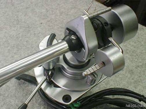

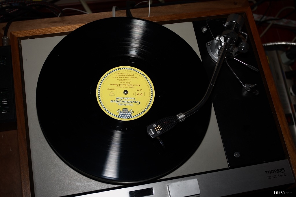

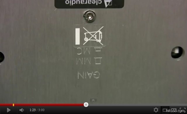

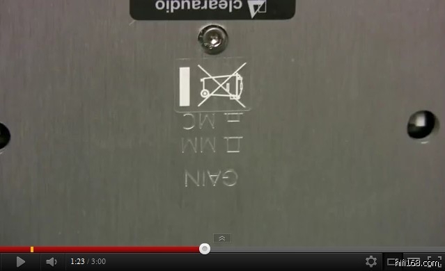

咝咝的破音与唱放没关,SME3009唱臂当初设计可能是为了MM唱头,如果用上MC唱头重量会大增,需要调节一下后面的重量平行一下,如果唱头太重还得加重一下后面的重量。

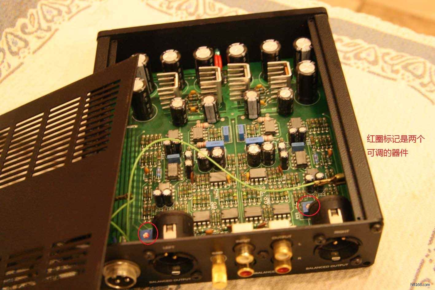

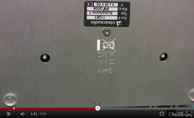

原帖由 fatdragon 于 2012-2-14 14:15:00 发表
http://www.vinylengine.com/turntable_forum/viewtopic.php?p=49360
老版本(黑色)后面有两个跳线,新版本的也有,见下图:
jpg(2012/2/14 14:21:34 上传)

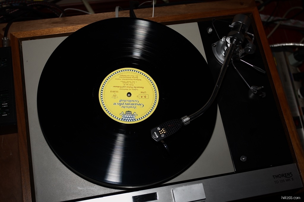

原帖由 林启明 于 2012-2-14 14:22:00 发表
丝丝声破音要检测唱头超矩是否正确,还有VTA宁略高勿偏低。
通用这款唱臂的用家能否共享下这只长臂的参数?谢谢

请教clearaudio symphono唱放匹配问题
唱臂参数:
SME 3009 S2 Improved
3009 S2 Imp: detachable headshell. Aluminum arm tube, effective mass 6,5g (3009 Imp) or 9,5g (3009 S2 Imp). Nylon knife-edge bearings. One-piece disc-shaped counterweight, threaded. VTF set using outrigger, one weight. VTF range: 0 -1.5g. Lateral balance is set by adjusting the position of the outrigger relative to the main counterweight. Antiskating adjustment by thread and weight, short axle with 6 notches.
Null points : 66 and 121mm.
Mounting distance (bedplate centre to turntable centre) : 215,4mm.
The differences to the Series II arms are easily recognizeable by looking at the weights.

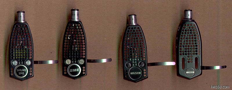

唱头盖是从左至右的第三个。
