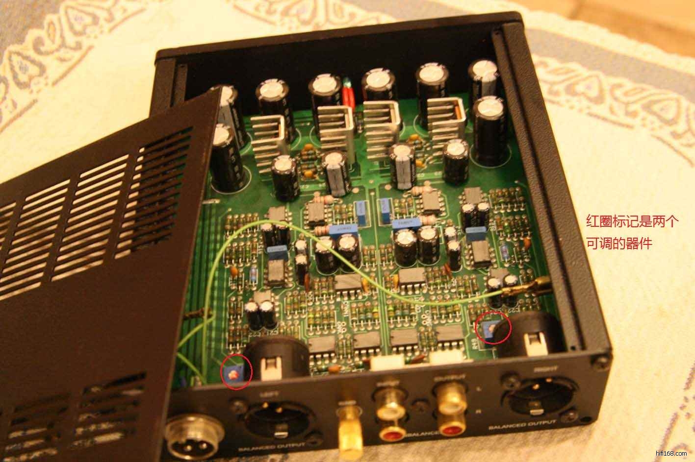

老版本(黑色)后面有两个跳线,新版本的也有,见下图:

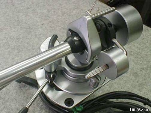

通用这款唱臂的用家能否共享下这只长臂的参数?谢谢

唱臂参数:
SME 3009 S2 Improved
3009 S2 Imp: detachable headshell. Aluminum arm tube, effective mass 6,5g (3009 Imp) or 9,5g (3009 S2 Imp). Nylon knife-edge bearings. One-piece disc-shaped counterweight, threaded. VTF set using outrigger, one weight. VTF range: 0 -1.5g. Lateral balance is set by adjusting the position of the outrigger relative to the main counterweight. Antiskating adjustment by thread and weight, short axle with 6 notches.
Null points : 66 and 121mm.
Mounting distance (bedplate centre to turntable centre) : 215,4mm.
The differences to the Series II arms are easily recognizeable by looking at the weights.

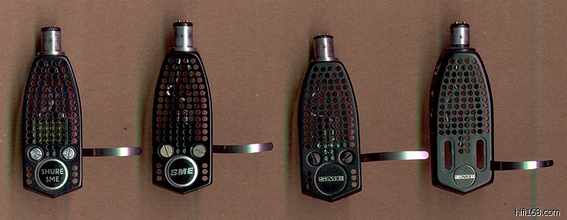

唱头盖是从左至右的第三个。
