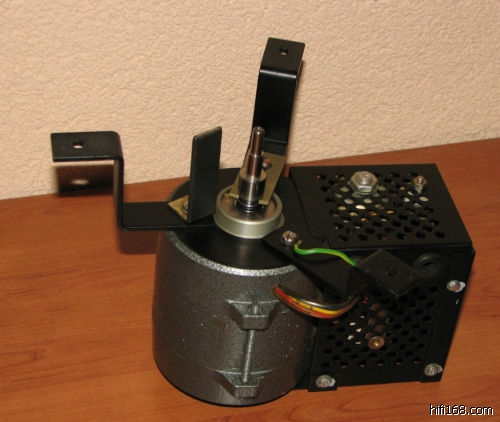

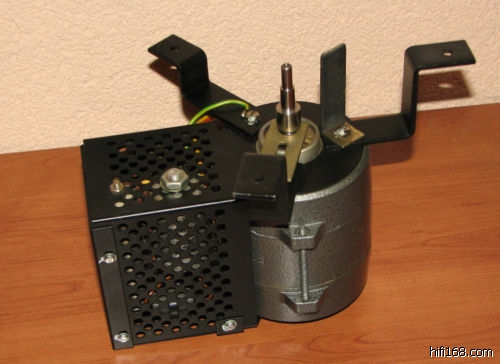

Technical Information EMT 930
Adjusting the motor capacitor
The drive motor for the EMT 930 uses 3 phases. As the motor is driven directly with the mains
voltage, which normally uses Ground and one phase, there must be a created an additional
auxiliary phase. This is done with a resistor and a capacitor.
The capacitor (normally 1.75μF) is adjusted in the factory to a value, which gives a minimum
of hum in the machine. The adjustment is done by adding small capacitors.
During live time, the value of the original capacitor will change. This can be recognized by an
increasing hum, by a rising motor temperature and by feeling the motor vibrating.
Adjustment
Tools needed:
Millivoltmeter, Oscilloscope
How to adjust?
BE CAREFUL, BECAUSE YOU WORK WITH MAINS VOLTAGE!!!
DON’T ADJUST THE VARIABLE RESISTOR!!!
First, if your unit is equipped with a basket at the motor, unscrew the basket, to get access to
the capacitor.
Connect the voltmeter and/or the oscilloscope the output.
Put the needle in an empty groove. Now set the main switch in a position, which is normally
not fixed, between the leftmost position and the middle position (that makes the motor
running, but the turntable is not rotating). Now one can see the hum on the
voltmeter/oscilloscope.
A cheap way will be, just to add small capacitors to the large one, to find a minimum of hum.
But in some cases the value of the capacitor has grown, so that the hum will enlarge.
In that case you have to go a less cheep way and you might order a complete kit of capacitors
(including the large one) with the order number 9 930 902.
Then exchange the large capacitor, solder small capacitors in parallel to the large one, until
you reach the minimum of hum. Then fix the basket again and enjoy your hum free EMT 930.

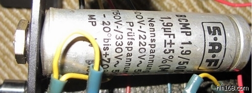

EMT有一套维护组件,编号为9 930 902,其实是一套不同数值的电容,包括
Capacitor 0,015 μF 4 132 632
Capacitor 0,022 μF 4 132 630
Capacitor 0,047 μF 4 132 240
Capacitor 0,068 μF 4 132 621
Capacitor 0,1 μF 4 132 624
Capacitor 0,15 μF 4 132 628
Capacitor 1,75μF 4 136 081
按照资料解释,一旦测试出C2电容老化等问题,就可以在连接示波器的同时,将套件中的电容从小到大依次并联到原本的1.75uf上面,进行调整,直到马达额震动和哼声最低。
对!这是通过电阻、电容调整最佳磁力线的很好方法,达到马达额震动和哼声最低。这里应有一个参照波形吧。
485欧姆的阻抗是调节了可变电阻后的实际值,不必和标称最大值一样.
如果怀疑C2电容老化,数值变化,可以拆下来,实际测试下,也不困难.然后通过并联串上同等数值的电容就可以了,不过注意耐压.当然,如果有仪器,就更好了.

1、C2电容的问题还是好解决的,更换、串联新的电容即可解决问题,且最好是用1.75uf的电机启动电容
2、问题是哪个可变电阻,总的电阻值目前是485,或许是出厂值,但是你不保证被上家动过,也就是485真的是出厂指标吗,这个是目前不能确定的。而且资料上也没有说明如何去调整可变电阻的数值,只说了一句“千万不要去碰那个可变电阻”

应该是930原配的电机启动电容
