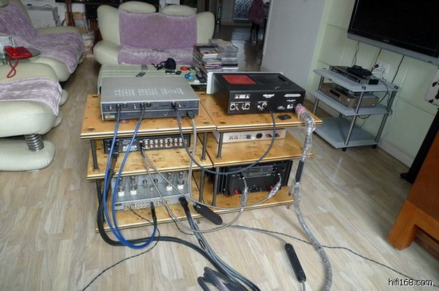

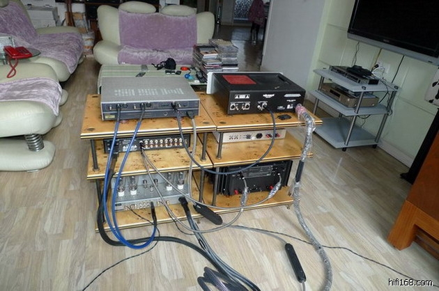

这个周末又收到了一些新的东西,给系统增添了一些调教的乐趣。它们分别是:

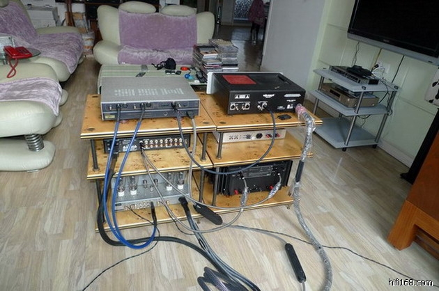

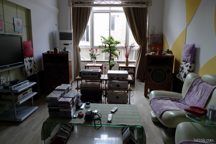

1.和本地号角和胆机大玩家安德森兄以SPARK A300P置换了一只SYSTUNE机架,这样我的两个贵族单层架可以光荣退休了。有了一对SYSTUNE器材架并排摆放,我的器材可以全部落架,客厅显得清爽许多,同时带来的声音的提升也是可闻的,主要表现在更为中性(对比之下,贵族木脚架多少带有一些所谓的“木味”的染色),更多的细节,更好的线条感,结像音场的立体感。

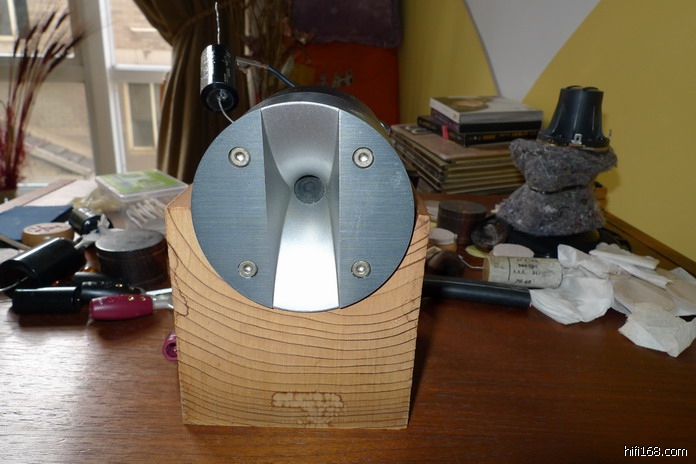

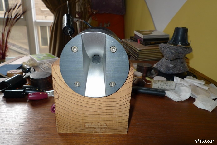

2.EXCLUSIVE ET-703压缩式号角超高音驱动单元。是通过论坛的一位朋友从日本辛苦寻觅所得。最近通过多个渠道所了解的情况是先锋可能停产TD4001和ET-703,并且已经大幅度提高了出厂价格。而成色良好的二手ET-703超高目前非常罕见,价格也在不断上涨。鉴于以上原因,同时也受到TAD小陈兄的鼓励,此次痛下决心定了一对ET-703,也算是为2402找到了一对比较理想的超高组合。
在入手前曾经考虑过先锋另一款有名的PT-R9超高,只是在请教了TAD超高的玩家后,反映和ET-703相比,PT-R9声底稍显单薄,能量不及后者,而ET-703除了有良好的超高延伸,还有着厚润的声底,而日本的TAD玩家多数给2402,2401等号角搭配ET-703,其中豪华用家甚至每边配置两只ET-703做正反相驱动。胆艺轩大烧“郊区农民”也是以ET-703作为其西湖TM-3的御用超高,据听过的朋友反映,“日前有幸在农民伯伯处领略了Exclusive  ET-703,惊叹此为音响史上再靓声的超高音单元,其频响最高达40Khz...TAD的超级杰作!"绕梁三日"...冠以此词绝不为过,高频及超高频之通透、自然令人着迷,特为追求高质素超高的发烧友推荐。”(原贴链接:http://www.tubebbs.com/viewthread.php?tid=68213&highlight=703)
除了ET-703单元,朋友还送了一对TAD原厂为其定制的木头架,正好可以将超高放在架子内。
先贴些ET-703的说明和技术指标供TAD爱好者们参考:
The ET-703 is a compression horn super high-frequency loudspeaker designed for a wide frequency range and high input power. This makes the driver especially suitable for monitoring digital sound.
VOICE COIL The voice coil is formed by edgewise-wound pure aluminum wire coated with a thin film of alumite, in order to make the most of the magnetic circuit's high magnetic flux. High input power is also achieved through the use of heat-resistant materials for the voice-coil bobbin and thermosetting resin.
MAGNETIC CIRCUIT A high-energy, rare-earth cobalt magnet is used in the magnetic circuit that, together with powerful soft iron for the pole yoke and plate, provides a high magnetic flux density of 20,000G.
DIAPHRAGM The diaphragm and surround are made from a single piece of pure beryllium manufactured by advanced vacuum deposition. With the highest resonance frequency set at 45kHz, the sound from the driver is free of coloration that can otherwise be caused by resonance. Extremely lightweight at 0.07g, it combines a wide frequency range, superb transient response and clear-cut definition.
DESIGN The ET-703 is a rear compression design featuring a computer-optimized precision phase plug. This ensures uniform phase response across the entire frequency range the unit covers. Moreover, because the surround is virtually vibration-free, both transparent sound and smooth, extending response are achieved.
CROSSOVER We recommend that the crossover frequency for the ET-703 be higher than 5,000Hz and the cutoff response 12dB/oct. or sharper.

从说明和指标上看,ET-703属于后部压缩号角驱动单元(带相位塞)。号角设计,钴磁体, 1.5英寸纯铍振膜(真空沉淀法),高磁通量(4万麦),高磁通密度(2万高斯),高效率(107分贝),超高延伸平直(5K-45K)是其主要的技术特点,无论是设计,用料还是指标,应该说都可列为史上超高名器中的佼佼者。

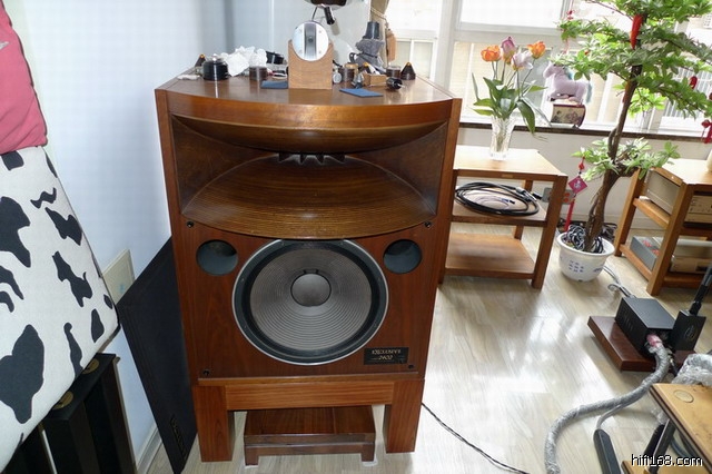

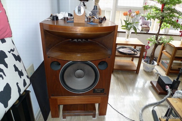

怀着虔诚和忐忑的心情,把原来的TAD300号角超高从2402顶部取下,将ET-703接入系统。由于ET-703和TD4001效率接近(4001为110DB),查阅了TH4001木号角的尺寸,发现号角的深度为41CM(也就是TD4001驱动头的大致位置),同时由于以前所采用的TAD300号角超高比较理想的位置为距前沿20CM左右,因此分别采用了20CM,30CM和40CM三个位置摆放ET-703来进行比较,初步感觉20CM时声音比较尖锐不够耐听,而退后到30CM时虽然有所改善,但仍旧有些许尖锐的感觉,最后退到40CM上述情况基本消失,音像也后拉少许,比较符合平衡耐听的要求。因此最终确定表现40CM为超高最理想的摆放位置。只所以和TAD300号角的摆位有如此大的距离,个人分析可能是ET-703的能量感大大超出TAD300号角,如果仍旧采用20CM的摆位,会产生比较强烈的压迫感。40CM仅仅为目前初步确定的位置,不排除随着系统和摆位进一步的调整对此进行微调的可能。

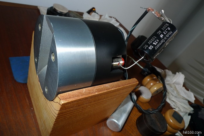

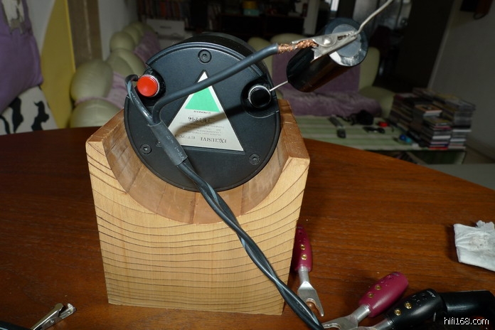

至于ET-703接入2402的方式,仍旧采用以前一直使用的最简单的串联电容一阶分频的方式,分别尝试0.1UF, 0.22UF, 0.47UF三颗电容分在不同的频率。2402和超高的喇叭线是相同型号-TAD300的随箱线。首先尝试分频点最低的0.47U的分频电容,感觉和不加超高相比,高频的延伸,细节表现,线条感的细致度,空气感,以及乐器的定位所带来的提升非常明显,但同时也发现整体音色偏干和薄,导致音场的形体比较平面。而在接上0.1UF的电容做最高分频时,发现声音稍显暗哑滞重,和不加超高时的表现区别不是非常明显。而在加0.22UF电容时感觉重放既有足够的厚度,又有足够明亮的中高频表现,虽然中频的厚润和致密的质感有所削弱,但总体的负面影响不大,同时TAD2402开始呈现出一定的活泼,开扬的声音风格。
