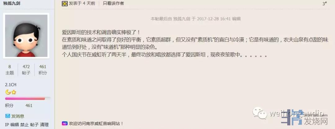

插播烧友评论一则:
(38.65 K)
2018/1/4 11:46:02
