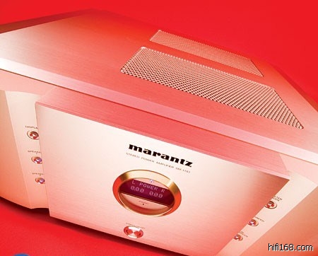

Inside the copper-clad chassis
铜机身内部
The SM-11S1, reminiscent in styling of Marantz's classic Model 9, israted at110Wpc into 8 ohms or 220Wpc into 4 ohms, 20Hz–20kHz, both withboth channelsdriven.
SM-11S1输出功率为为110瓦 8欧姆或220W 4 欧姆
Marantz claims that itssymmetricalParallel Line Layout, which you can see when you remove thethick,nonferrous aluminum cover, minimizes the current loop's path, andso improvesthe circuit's ability to reject external noise and limitsthe amount of noiseit generates itself.
马兰士采用对称平行设计,尽可能缩短电流路径,从而减小自身噪音与外部干扰。
A large, 14.5-lb toroidal transformer isencased in an aluminumenclosure and bolted to the chassis through a 10mm-thickaluminum baseplate. The transformer has a double core of silicon-steelsheet;acoustic-isolation plates and spacers between the primary andsecondary coilsare claimed to improve its rejection of high-frequencynoise.
铝外罩罩着一个重达14点5磅的环型变压器,并且通过一块十毫米厚的铝板被固定在机箱底板上。这个变压器具有两个硅钢板制成的核心。在主次线圈间采用隔音板与间隔装置用来隔绝高频噪音。
The transformer'sbifilar-wound(parallel) coils, permit separate rectification of theleft and right, positiveand negative voltage rails. That and otherpower-supply innovations are claimedby Marantz to eliminate capacitivecoupling, and produce degrees of channelseparation and ambienceretrieval comparable to those of separate monoblocks.The power supply'stwo custom-designed 15,000µF filter caps per channel aresimilar tothose used in the MA-9S2 and were chosen for their sound quality.
变压器的双重平行结构,使左右的整流与正负电压有独立通路。马兰士宣称采用新技术提高声道分离度使其能与单声道功放媲美。电源供给由两个定制的15,000µF电容。
High-quality components,includinghigh-speed Schottky diodes and the same Blue Star caps used inthe SC-7S2 andMA-9S2, are used throughout the SM-11S1, which also usesno fewer than 34compact HDAM SA3 ultra-high-speed amplifier modules.The SA3, the latestiteration of Marantz's High Definition AmplifierModule (HDAM) complementarycascade push-pull circuit, is a compactarrangement containing high-precision,surface-mount metal-filmresistors said to be stable and to remain within specthroughout a widerange of temperatures.
被用于SC-7S2与 MA-9S2的高品质元件包括高速二极管,Blue Star电容,都被用于SM-11S1。使用了多达三十四件超高速HDAM SA3元件,HDAM SA3是马兰士最新版本的高精度放大元件。拥有高精确性与稳定性。
The SM-11S1 uses two stages ofoutputamplification: a 13dB voltage amplifier, and a 10dBpower-bufferamplifier capable of providing sufficient instantaneoushigh-current drive tocounteract back EMF from the drive-unit and thusbetter control the speakercones' excursions.
SM-11S1
采用两级输出放大,第一级是13dB的电压放大。第二级是10dB的功率缓冲放大。这样做的好处是提供足够的瞬间大电流来减小反电动势从而控制喇叭。
The first stage of thistwo-stageamplifier is a fully balanced, current-feedback voltageamplifier that lowersthe signal impedance and is identical to the oneused in the more expensiveMA-9S2. HDAM SA3 modules handle thedifferential input, with each inputindependently buffered. The secondstage, a current-feedback power-buffer ampincorporating the aforesaidcomplementary cascade push-pull circuit, drives thespeakers directly.
其中,第一级放大是全平衡放大。电流反馈电压放大器降低了信号阻抗,这级与昂贵的MA-9S2采用相同的设计。HDAM SA3元件处理不同的输入,给予相应的缓冲。第二级,电流反馈,功率缓冲放大,汇合前一级放大的推挽电流直接驱动喇叭。
Is it important that you know thisstuff? Perhaps not, but surely many readers understand the terms push-pull,complementary, and cascade,though the SM-11S1's incorporation of"Wilson current mirror" and"cascade bootstrap" circuitsprobably does push the knowledge envelope.The important thing to know aboutthese buzz words is that they areclaimed to improve the SM-11S1'sultra-high-frequency performance whilelowering distortion, which should beimportant in the reproduction ofmusic from SACD and DVD-Audio discs.
或许,你没有月噢知道上述原理,但是很多读者应该明白上述的一些名词,比如推挽等。但其实,这些文字都是为了说明马兰士在低失真下提高SM-11S1的超高频表现,而超高频表现对于SACD与DVD-Audio的还原是很重要的。
