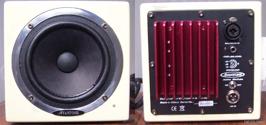

Avantone Active Mixcubes 被设计具有高辨识率, 使迷你监听器的能力为全范围为固定的或细微的区域。
辅助的工程方面将创造成一种永久的一个完整范围的转换器。
性能目标

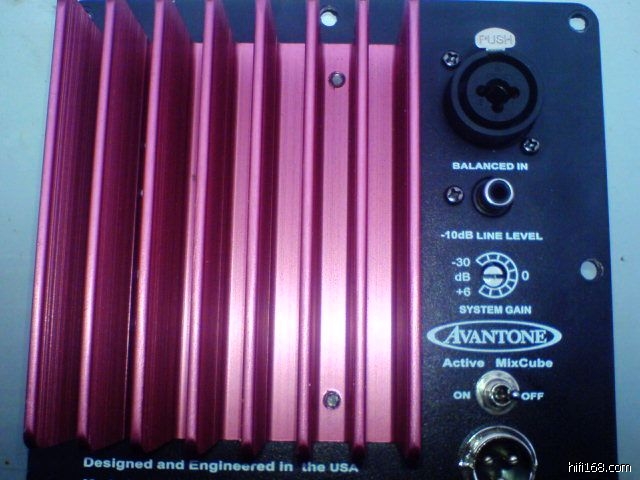

balanced in: this “combo XLR” input accepts a BALANCED male XLR plug as well as a 3-conductor BALANCED TRS1/4” or a2 conductor UNBALANCED TS1/4” male plug. For unbalance operation with a TS connector the minus signal is automatically grounded.
XLR
TRS
RCA
HOT(+)
Pin2
Tip
Tip
COLD(-)
Pin3
Ring
SHIELD(GROUND)
Pin1
Shield
Shield
@-10 db LINE LEVEL: this input accepts a male RCA/Phono Plug at a -10 unbalanced operating level.
@SYSTEM GAIN: this variable trim set control adjusts the sensitivity of the signal that appears at the input. rotating the control clockwise increases the sensitivity while a counter-clockwise rotation decreases sensitivity. The adjustable gain range is from -30 to -6 d B. A setting of +6 allows a full, unimpeded signal to be sent to the amplifier. The trim pot may be adjusted with a small flathead screwdriver. Please note…when the signal appearing at the input is too hot, the amplifier can overload causing distortion and possible damage to the speaker. If overload occurs, attenuate (decrease) the input level by turning the trim pot counter-clockwise a few clicks.
@ON/OFF Toggle Switch: this switch turns the amplifier section on and off. The unit is still receiving power from the transformer however. In the “OFF” position a RED LED will be illuminated on the lower right front of the MixCube cabinet. When in the “ON” position the LED will be BLUE.
@AC IN: this input is only to be hooked up to the proprietary AVANTONE Power Supply Transformer. Tighten the cable/connector securely for reliable operation. Note: There is a switch on the transformer for selecting the proper AC/MAINS operating voltage for your location.

当放置在台子或控制台上的 AVANTONE MixCubes 以桥连接时用户应把他们留在与使用时耳朵水平的高度,而且最好轻微地按某一角度转动在向使用人员。最适宜的音响放置距离为把监听器放在自彼此的距离等于和与使用者耳朵间的距离,即两音箱与使用者三者分别为一等边三角形三个端点。
MixCubes 在使用过程中把他们放置靠近显像管,电视的监视器或电视的其它部位是不会引起任何的问题。 他底部的 5/8"*27 mic的垫脚也将会使他在不寻常的工作场所中允许你有更多的定位方式来放置他们以便更好得为您的目的发挥其功能
Mix Cubes的连接方式
在使相关电源和你的Mix Cubes上连接之前请花一些时间确定适当的 AC 电源插头的提供电压与Mix Cubes设定电压相互适合。 开启时所有的监听器均应为最小音量控制开启。 所有的其他播放设备或你的控制台设备也应该在打开 MixCubes 之前如上使用小音量,如此可避免瞬间的大声引起强烈振动和影响。 输入 " SYSTEMGAIN" 控制处为了避免开始的上时意外的超载,在出厂时的设定均为最小量被设定。这一预默认预设使用户在充分的使用时时监听器更安全的输出关于来自播放设备及控制台的送给输出。

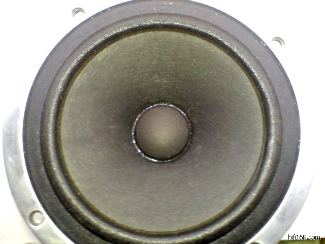

扬声器: 8个欧姆 5.25" 阵容铝框架 / 圆锥体纸盆
