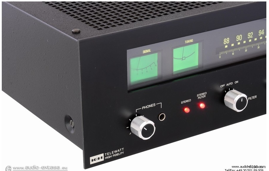

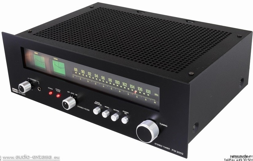

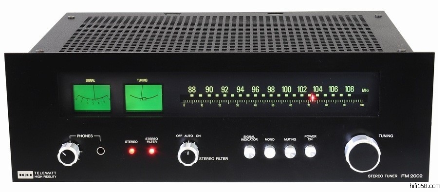

俺喜欢K+H FM2002收音头,试过跟密林,金嗓子比较,其他都被秒杀了。
38#
K+H Telewatt FM 2002, HiFi Stereo FM Tuner of the world-class!
Specifications:
Manufacturer: Klein + Hummel, Germany
Frequency range: FM: 87,5-108 MHz
Frequency response: 12 Hz-16,5 kHz (-3 dB)
THD: 0.15%
Signal to noise ratio: Mono: 72 dB, stereo: 69 dB
Crosstalk: > 40 dB
Pilot signal attenuation: > 70 dB
Selectivity: 92 dB
IF-attenuation: > = 100 dB
Image rejection: > = 100 dB
Equal wave selection: 0.7 dB
Bandwidth: IF-amplifier: 120 kHz, FM-demulator: 1800 kHz
AF-output voltage: Fixed: 1.5 V, variable: 0-1.5 V/< = 50 ohms
Dimensions: 392 x 115 x 280 mm
Weight: 7 kg
Retail price in Germany in 1979 was: 3400,- DM
jpg(2011/4/4 12:54:04 上传)
