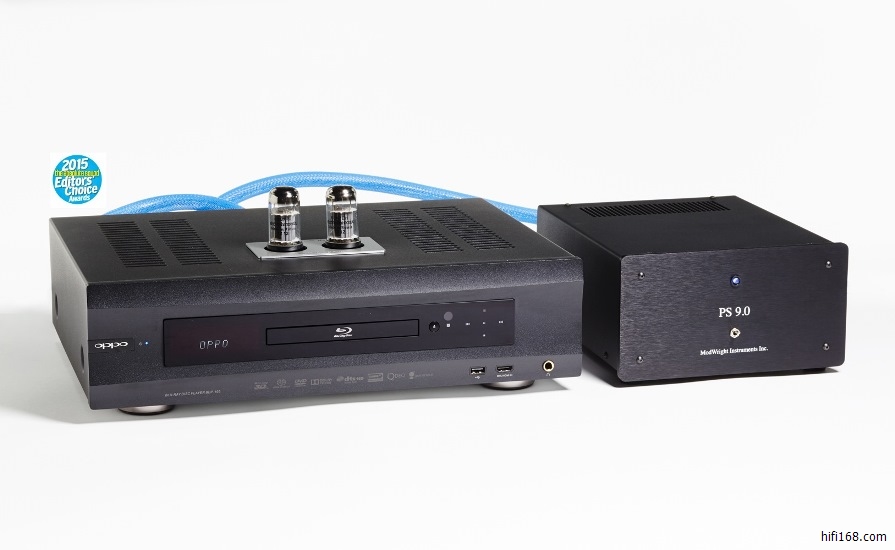

OPPO 105D的打磨是美国的MODWRIGHT公司做的。最主要的部分就是把模拟输出的部分改成了胆输出,用了一对6SN7。然后就是用了新的外接胆电源。
详细看这里:
  • Total redesign and replacement of single-ended and fully balanced output stage with our own tube analog stage (6SN7 driver tubes).
  • External PS (new design) with one rectifier (5AR4, GZ34, 5U4, 5V4 and equivalents) and two voltage regulator tubes (13EM7,12EM7 and suitable subs.)
  • ‘Truth’ umbilical of our own design.
  • Upgraded Cardas GRFA series RCA’s for stereo outs.
  • Upgraded Furutech cryo-treated IEC.
  • Highest Quality resistors in key signal path applications.
  • All signal wire = 99.9999% pure, cryo-treated solid-core silver wire from Cardas metals.
  • Upgrades to internal stock power supplies (Linear power supply replacement for stock SMPSnot included )
  • Damping mods for chassis and transport.
  • External supply available with optional ‘Hole’ to allow for use of taller, larger diameter tubes other than 5AR4/GZ34 (just ask).

美国文伟摩机改机是比较有名的,但收费应该也不会低,弄不好要超过OPPO本身的机价。

这种磨机对于回放SACD,似乎不合理,有待商榷。OPPO本身用的使用的是高解析解码器芯片,磨机芯片肯定不会动,只能在模拟放大和供电上下工夫,那么电子管在这两方面都不是优势。

正是。磨机的价格是2500刀,是oppo机器本身价值的2.5倍。

确实如此。DAC芯片没有动,但提供芯片的电源,还有模拟放大的线路都改动了。
