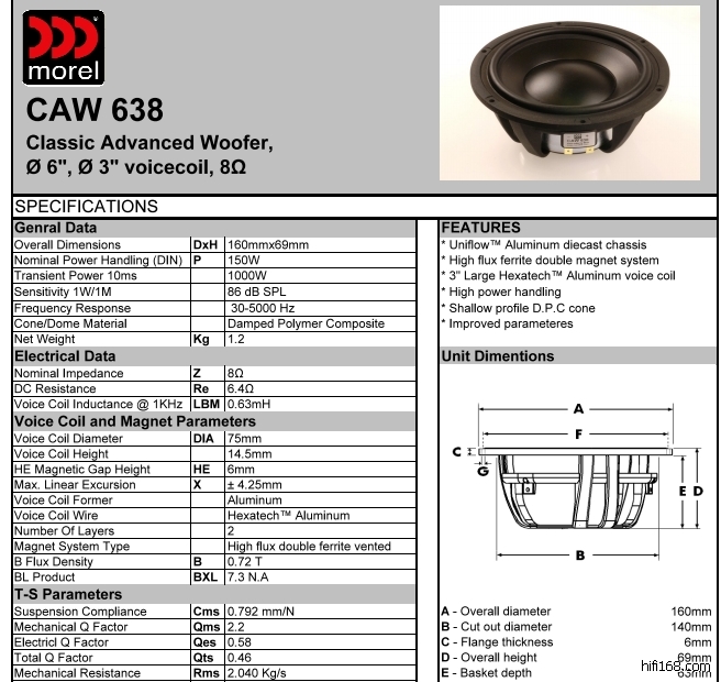

morel caw638
Morel CAW638 6" Woofer
Classic Advanced Series
  • Uniflow aluminum diecast chassis
  • High flux double ferrite magnet system
  • 3" Hexatech aluminum voice coil
  • High power handling
  • Shallow profile Damped Polymer Composite cone
Frequency response 45Hz to 5000Hz
8 ohm Impedance
150W Power Handling (DIN)
86dB Sensitivity (1W/1M)
3" diameter voice coil, 2 layer
4.25mm X-max (peak)
Fs 44 Hz
Re 6.4 ohm
Le 0.63mH
Qms 2.2
Qes 0.58
Qts
0.46
BL
7.3
Cms 0.792 mm/N
Mms 16g
Rms 2.04 Kg/s
Vas 15.7 liters
Sd 119 cm2
Flange diameter: 160mm (6.3")
Cut out diameter: 140mm (5.52")
Depth: 63mm (2.5")
Suggested box sizes:
0.4 cubic foot vented box with 1.5" diameter vent by 5.25" long for and F3 of 50Hz.
0.25 cubic foot sealed box for an F3 of 75Hz.
jpg(2015/2/28 19:29:20 上传)
