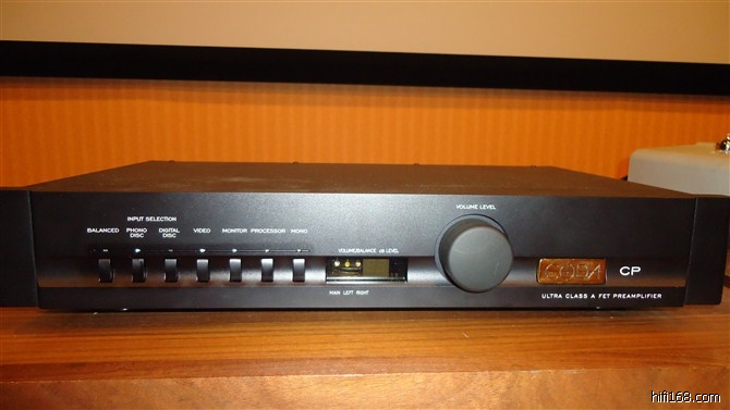

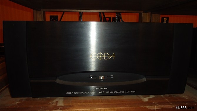

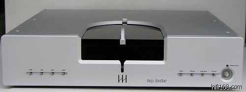

2012年6月16日、6月17日(本周六、周日)13:00-17:30北京飞韵美音响将在北京市朝阳区广渠门外大街8号优士阁大厦A座201室举办美国PBN SAMMY 落地音箱试听会,试听器材: 意大利清泉TL3CD机,美国CODA CP前级、15.0甲类立体声后级、60.0单声道后级、TM单声道后级,德国森特线材,美国PBN SAMMY落地音箱。 联系电话 01058614230,手机13811285459。联系人:茅及。

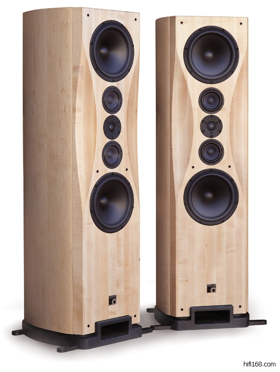

Before I first hear a loudspeaker, I’ve found it an interesting exercise to take a mental inventory of its parts and its overall design brief (usually found on the maker’s website), to figure out just what the sonic goals for the product are. Lots of drivers might mean the designer wants prodigious output capability. A single driver, conversely, would indicate a quest for extreme coherence. To my mind, the Sammy’s parts list and construction description seem pretty clearly to describe a dynamic-driver speaker that aspires to high performance while keeping to a moderate size (55"H x 16.5"W x 21"D, 215 pounds each). In fact, PBN states that the Sammy embodies their new Compact Reference Platform: state-of-the-art sound in a real-world package.

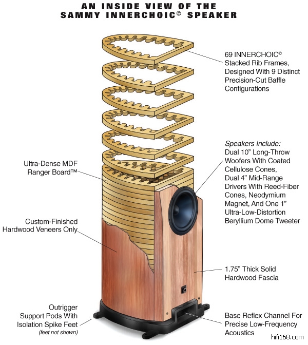

Starting at the top, the Sammy’s beryllium tweeter, made by Scan-Speak, doesn’t come into play until a high 3400Hz. Beryllium has been shown to be an exceptional substance for use in tweeters -- the metal’s first breakup mode doesn’t occur until past 40kHz. This behavior should equate to advantages within the realm of human hearing (20Hz-20kHz) because this form of distortion would occur well outside of what a listener could hear, and therefore doesn’t have to be suppressed by the crossover. Beryllium is simply more advanced in its use, and more expensive to manipulate, than other materials of which tweeters are commonly made, such as aluminum, titanium, ceramic, and silk. Score one for the Sammy.
Next up are the two midrange drivers, each a 4" Scan-Speak Illuminator with a neodymium magnet, and covering the range from 170 to 3400Hz. These are just about the best drivers Scan-Speak makes. These are top-shelf midrange drivers that easily best many of the other drivers available to speaker companies, like PBN, that don’t build their own. And they’re likely better than a lot of drivers made by companies that do build their own.
Last up are the two woofers, 10" natural-fiber units also from -- you guessed it -- Scan-Speak, but this time a Revelator model, S-S’s top line before the Illuminators came along. The outputs of the five drivers are governed by a crossover with slopes said to be fourth-order, 24dB/octave, and the drivers themselves are arrayed on the Sammy’s contoured front baffle in a D’Appolito-type array: woofer-mid-tweeter-mid-woofer. The Sammy has a rectangular bass-reflex port on its front face near the bottom of the speaker.
The cabinet is built of stacked pieces of MDF cut on a CNC machine. These form what PBN calls its system of Interior Sonic Reflection Suppression. The interior of the cabinet is formed by the inner edges of the slabs of MDF, each of which is cut with staggered, rounded protrusions designed to break up standing waves inside the box. Even the internal braces and separate compartments for the midranges and tweeter are made of these horizontally opposed slices of wood. This is above-average construction for sure, at least when compared to simple sheet stock glued together, and a noble attempt at designing a box with good sound in mind. Knocking it with a knuckle, however, didn’t reveal a box any more inert than some of the more conventional speaker cabinets I’ve rapped lately, from the likes of Dynaudio and EgglestonWorks.
A single set of binding posts is inset into a small panel at the bottom of the speaker’s rounded rear, and an integral base attaches to outrigger feet: slabs of aluminum that accommodate the supplied spikes and permit easy leveling of the cabinet without having to tilt the whole speaker -- a handy touch. The wood veneer was as nice as I’ve seen lately, with a deep, attractive grain flawlessly applied. My review samples had a smooth matte finish, though I’m sure PBN could gloss it up for you for an additional cost. Many custom real-wood veneers are available, as well as automotive-grade paints.
One detail bothered me: The recess for the binding posts was simply painted black, exposing the edges of the MDF slabs that make up the cabinet proper; I’d like to have seen a more finished look. This is a small thing, granted, but I’m picky. The binding posts also seemed a bit chintzy, though they worked just fine.
The Sammy’s claimed frequency response is 24Hz-37kHz, +/-2dB; its efficiency is rated at 92dB, and its nominal impedance is 4 ohms. The recommended range of amplification is 25-500W.
All in all, the Montana Sammy, sitting unboxed in my room, looked more than competitive with most of the other designs I’ve seen at or near its price. It implements some expensive drivers in an ambitiously designed cabinet and is beautifully finished, albeit with a few small details that kept me from giving it a score of 100% -- at least before I did any listening.
