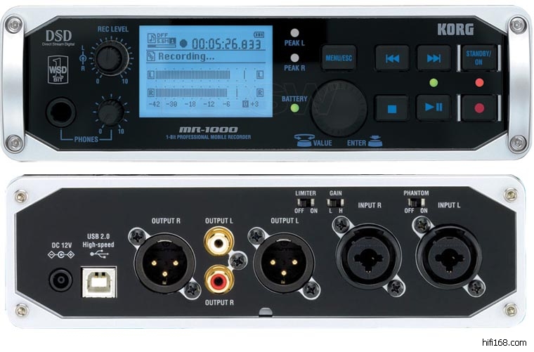

Korg-MR1000的介绍
The future is now. Wow!
This super-portable professional mobile recorder boasts extreme high fidelity 1-bit recording technology, delivering a mind-boggling 1-bit/5.6 MHz that literally doubles industry DSD recording quality standards. It's sure to become the gold standard of professionals who want to record and archive their final mixes in the studio, while its compact size makes it perfect for location recording, podcasting, live music and just about every other application this new century will demand.
1-bit recording is the newest wonder of the audio world and has been adopted for use in the SACD recording format. Its uncompromising fidelity, low noise floor, extended dynamic range, lifelike imaging and analog quality depth have been praised by top experts. Another benefit of the 1-bit format is that it can be converted to any other bit depth and sample rate without error or degradation. After recording and editing all your tracks in the DAW/hardware system of your choice, you can mix directly, or via an analog summing mixer, to the MR-1000. This gives you the superb fidelity of high-rate 1-bit technology, which preserves all the transients, nuances, and “air” from the original recording. It also comes bundled with powerful AudioGate software that lets you convert your 1-bit recordings and mixes into all of today's audio formats without degradation. Best of all, by archiving your data/mix in this new double-speed 1-bit format you're ready for the future. Even as playback systems and standards continue to evolve, you'll be a step or two ahead of them. It supports multiple recording formats including DSDIFF, DSF and WSD 1-Bit formats as well as multi-bit PCM format (BWF) with resolutions up to 24-bit/192 kHz. Its 40GB internal hard drive gives you a up to six hours of recording at the highest audio quality (1-bit 5.6448 MHz stereo), or approximately sixty hours at CD quality (16-bit 44.1 kHz). It sports combination XLR/ 1/4" input connectors with top quality microphone preamps, phantom power and built-in limiting, and offers both XLR and RCA outputs for maximum flexibility. Main Features:
• High fidelity 1-Bit recording technology
• 40GB internal hard drive
• Supports multiple recording formats
• Up to 6 hours of recording at highest audio quality
• Approximately 60 hours of recording at CD quality
• Comes with powerful AudioGate software
• Combination XLR/1/4" input connectors
• High quality mic preamps, phantom power and built-in limiting
• High-Speed USB 2.0 connectivity for lighting quick file transfer
• XLR and RCA outputs Specifications: Recorder Section:
• Number of Tracks: 2 tracks, 2-track recording/playback simultaneously
• Recording Formats: 1-bit audio formats - DSDIFF, DSF, WSD: 2.8224 MHz @ 1-bit, 5.6448 MHz @ 1-bit
• PCM audio formats - WAV, BWF: 44.1 kHz @ 16/24-bit, 48 kHz @ 16/24-bit, 88.2 kHz @ 24-bit, 96 kHz @ 24-bit, 176.4 kHz @ 24-bit, 192 kHz @ 24-bit
• MP3 format - playback only 44.1kHz/32kbps-320kbps (MP3 format support will be added in an upcoming free update. This system updater is expected be available in the middle of 2007 via KORG distributor's websites)
• Internal Hard Disk Drive: 40 GB
• Recording Time: Max Approx. 31 Hours (44.1 kHz @ 16-bit, 2-track)
• Number of Projects: Recognizes a maximum of 200 for each format, max 1,000 projects
• Mark Points: 100 points per a song (no mark name)
• USB Functions: USB 2.0 supported, ability to use as FAT32 external USB drive
• Song Editing: Rename, Delete, Protect General:
• Display: 160 x 104 dots LCD with backlight
• Dimensions: 192(W) x 170(D) x 56(H) mm/7.56"(W) x 6.69"(D) x 2.20"(H)
• Weight: 1.0 kg/2.20 lbs. (without batteries)
• Power Supply: AC Adapter, or eight AA batteries (sold separately), Oxyride batteries, or charged nickel metal-hydride batteries
• Current Consumption: 7 W
• Accessories: AC Adapter; Carrying Bag; CD-ROM ("AudioGate" Audio File Conversion Software) Principal Specifications:
• Frequency Response: 10Hz ~ 20kHz ±1dB @ Fs44.1kHz, 10Hz ~ 40kHz ±1dB @ Fs88.2kHz/96kHz/176.4kHz/192kHz, 10Hz ~ 100kHz (1 bit)
• S/N: 96 dB (typical) @ IHF-A INPUT-OUTPUT
• THD+N: 0.008% (typical) 20 kHz-LP
• A/D Conversion: 2.8224 MHz/5.6448 MHz (1-bit), 24-bit (PCM)
• D/A Conversion: 2.8224 MHz/5.6448 MHz (1-bit), 24-bit (PCM) Input L-R:
• Connectors: XLR-3-31 type / 1/4" TRS phone jack (balanced); Phantom power: 48V/10mA per channel, on/off switch
• Input Impedance: 4.5 k Ohm (XLR-3-31), 68 k Ohm (TRS phone, Line)
• Nominal Level: - 60 dBu - - 28 dBu, XLR (balanced), - 26 dBu - + 4 dBu, 1/4" TRS phone (balanced), - 26 dBV - - 6 dBV, 1/4" TRS phone (Unbalanced)
• Maximum: 16 dBu, XLR (balanced), + 16 dBu, 1/4" TRS phone (balanced), + 6 dBV, 1/4" TRS phone (Unbalanced) Output L-R (Unbalanced/Balanced):
• Connectors: RCA (Unbalanced)/XLR-3-32 type (balanced)
• Nominal Level: 6 dBV/+ 4 dBu
• Maximum Level: + 6 dBV/+ 16 dBu
• Load Impedance: 47 k Ohm or greater/600 k Ohm or greater Phones:
• Connector: 1/4" stereo phone jack
• Load Impedance: 16 k Ohm or greater
• Maximum Level: 50 mW + 50 mW @ 32 k Ohm USB:
• Connector: Type B
• Format: USB 2.0 High-Speed device, USB mass storage class
• Supported OS: Windows Me, 2000 or later, Mac OS 9.0.4 or later Included Items:
• AC adaptor (also operates as charger), carry bag, CD-ROM (“AudioGate” audio file conversion application) AudioGate System Requirement:
• Supported OS: Windows XP Home Edition/Professional Edition (Service Pack 1 or later), Mac OS X 10.3.9 or later
• CPU: [Windows] Intel Pentium III/1 GHz or faster [Macintosh] Apple G4/800 MHz or faster (Intel-based Mac supported)
• Memory: 256 MB or larger (512 MB or larger recommended) Read a review on this product at www.podcastgearguy.com.
Korg rear interface.jpg (, 下载次数:140)
jpg(2009/1/30 11:09:08 上传)
