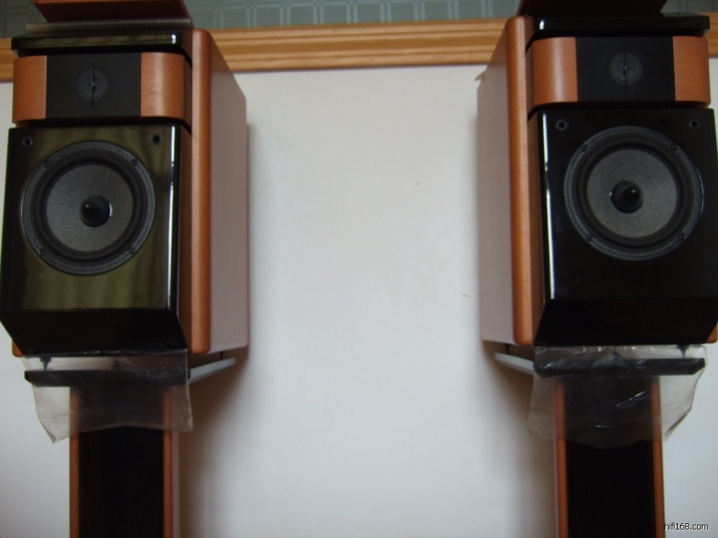

已购音箱:MICRO  UTOPIA

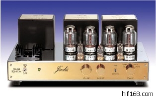

目前看好的胆机:JADIS DA-50 Signature

目前看好的胆机:JADIS [attachimg]98411[/attachimg]DA-50 Signature
