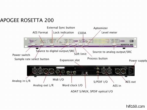

不好意思,借楼主宝地一用。
cluytens 兄,小弟亦想入手RME HDSPe AES32,有几个问题想请教你:
1,兄的AES32是用什么接口的线接入HIFI系统;
2,购买AES32卡时有什么线会跟卡一起给用户的。

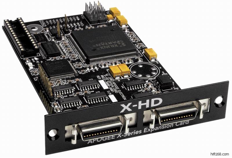

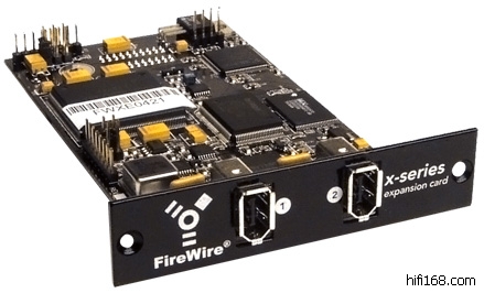

小弟初步设想是用AES32+Apogee
Rosetta 200  DAC(这个DAC已在用)作PC音源,但就还没弄懂这两者之间怎么个接法效果会最好;Rosetta 200是否还需另外配个火线卡呢?如需配的话,
X-Digi-HD及
X-Firewire 400那个更合适,谢谢!
Apogee
X-Digi-HD
Digidesign HD/HD Accel X series Expansion Card
At last Apogee makes the direct connection to Pro Tools | HD systems a reality. The Apogee X-Series-HD option card allows for direct connectivity between Pro Tools HD? systems and the AD&DA-16X, Rosetta 800 and Rosetta 200. The result is an incredibly powerful combination of Digidesign's? industry leading software and a new generation of superior Apogee conversion and clocking hardware that provides a workstation that will excite Apogee and Pro Tools? fans alike.
Apogee
X-Firewire 400
Firewire IEEE 1394'B' S400 X Series Expansion Card
The Apogee X-Series FireWire Card gives you the power and convenience of a direct connection to any FireWire equipped computer. The X-FireWire Card uses an expansion slot in the ROSETTA 800 to give users of Logic, Nuendo and other popular software the option of amazing sounding Apogee conversion. Using Apple’s Core Audio FireWire driver for Macintosh and ASIO drivers for Windows, your hardware options for your DAW are greatly expanded.
The two ports on the Apogee X-FireWire Card allow you to daisy-chain additional devices to create an entire system. By extending the bus, the X-FireWire card allows for daisy-chaining of multiple Apogee systems or compatible peripherals, and permits the use of multiple FireWire devices by computers with only one port. The card also passes power through the FireWire ports to allow the powering of additional devices. (Note: This feature is available for Windows systems only at this time).
With and X-FireWire card installed in an AD-16X, DA-16X, Rosetta 200 or Rosetta 800 you have the power of a professional FireWire connection to your favorite DAW: Logic 7, Nuendo, Cubase, Cakewalk, Live or virtually any native audio production software.

AES-32只有數位輸出
它的output是25pin D-sub的AES接口
原盒裡頭是沒附數位輸出線
這線原廠有賣,不過據說效果不佳
Rosetta 200  DAC
這機子後頭剛好有數位的XLR input
弟的組合:AES-32 + Lavry Blue D/A(這機子只有XLR input/output)
身旁幾個AES-32的用家都是用25pin D-sub → XLR的數位線,來連接AES-32 + Lavry Blue D/A
這線也剛好合你用
我們是跟一位線材個體戶訂製的,弟是買1.5m的,價格換算過來還不到300RMB

非常感谢cluytens 兄!基本上弄懂了连接问题,用25pin D-sub 转XLR或RCA接DAC,这个不难理解;小弟想再了解一下AES32与X-HD如直接相连出来的效果会不会好一点?不知兄及兄身边的AES32用家有没有这样的经验?
还有一种玩法就是给Rosetta 200  DAC装块X-Firewire 卡,然后与PC的1394火线接口直接相连,这样出来的效果不知跟用AES32接Rosetta 200  DAC那个好?
