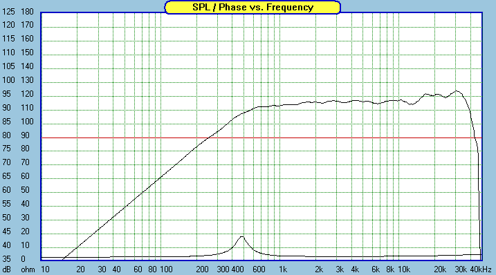

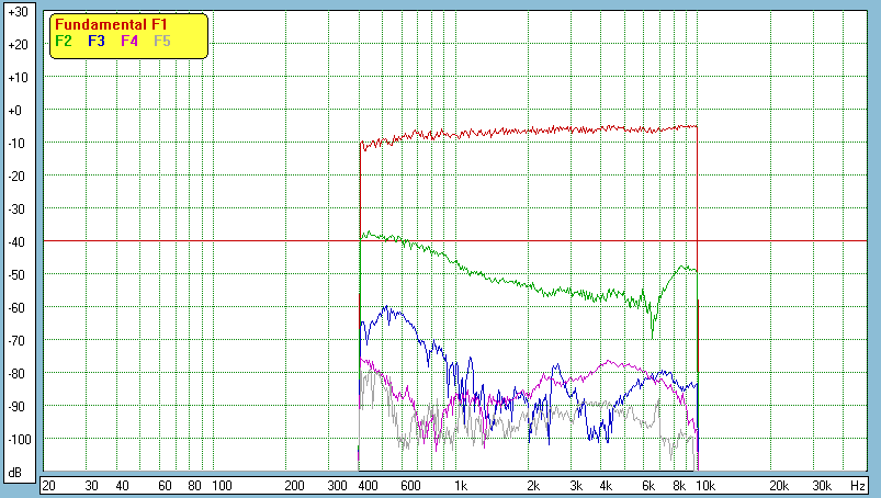

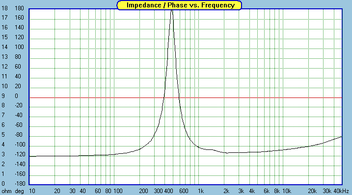

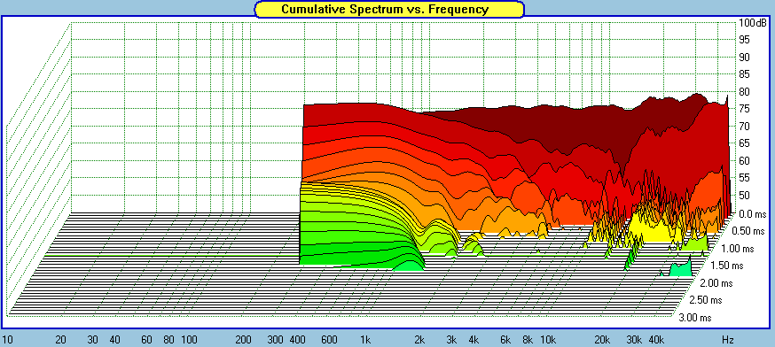

I've got another set of 6600's here for testing and I wanted to see what's happening with the current batches. As I mentioned previously, there was some variance from the 2006 version to the 2007 version when they went out of stock for a while with some supply issues. The news with the current batch is that they have been brought back closer to the original '06 measurements. Mostly, the sensitivity is back up to around 93dB. What I have in my hands here is looking pretty damn good. Smooth, extended and low distortion. Also, I might mention that they are now black rather than the dark gun-metal gray they used to be. They are also 0.3mm wider in diameter - I know this because the tweeter's didn't fit in my test baffle insert this time around. Scan-Speak's faceplate vendor has obviously been changed around a bit and I hope they've finally found one they can stick with.

在15K以上仍然有谐振峰,已经产生分割震动了,之所以15K以上灵敏度升高,是因为从15K以上突破了振膜的应力,开始以分割震动的形式发声。这时指向性也会变强!

15K以上有峰,正好补偿了人耳的缺陷,哈哈

阻抗曲线也非常好啊
