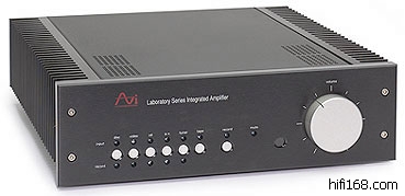

这是AVI网站上给出的图片和数据
Specifications
Frequency Response (-3dB)<1.5Hz - >250Khz
Input Impedance14k Ohms
Input sensitivity (150W into 8 Ohms, 1kHz)530mV
Tape Output Level (at rated sensitivity)530mV
Maximum Power Output (One channel driven):
8 Ohms, 1kHz, 1% distortion200W
4 Ohms, 1kHz, 1% distortion325W
2 Ohms, 1kHz, 1% distortion (note 1)480W
Maximum Power Output (Both channels driven):
8 Ohms, 1kHz, 1% distortion175W
4 Ohms, 1kHz, 1% distortion300W
2 Ohms, 1kHz, 1% distortion (note 1)420W
S+N/N Ratio Unweighted96dB
S+N/N Ratio IEC “A”112dB
Absolute Phase+VE
Distortion (T.H.D., 1kHz, -1dB below full power):
8 Ohms<0.002%
4 Ohms<0.002%
AC Mains supply (factory pre-set)110v-120v, 220v-240v
AC Mains consumption1000W max.
Dimensions (W X D x H)315 x 350 x 95mm
Shipping dimensions (W X D X H)400 x 440 x 170mm
Gross weight12.8Kg

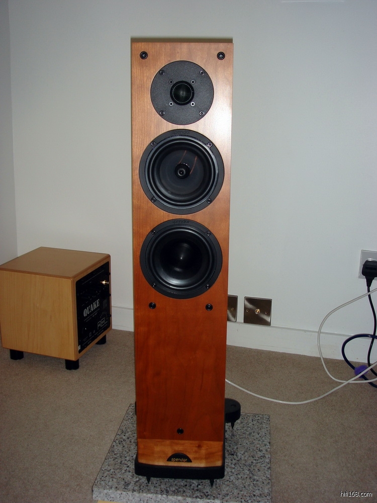

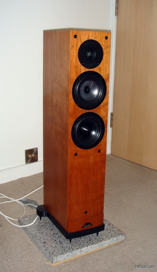

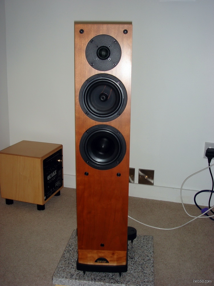

Seven Oaks店里试听用的音箱是Spendor S5e,电源线都是机线,信号线和喇叭线都是Chord的中档型号。
jpg(2007/9/13 2:31:47 上传)
最后编辑SMERT 最后编辑于 2007-09-13 04:55:58

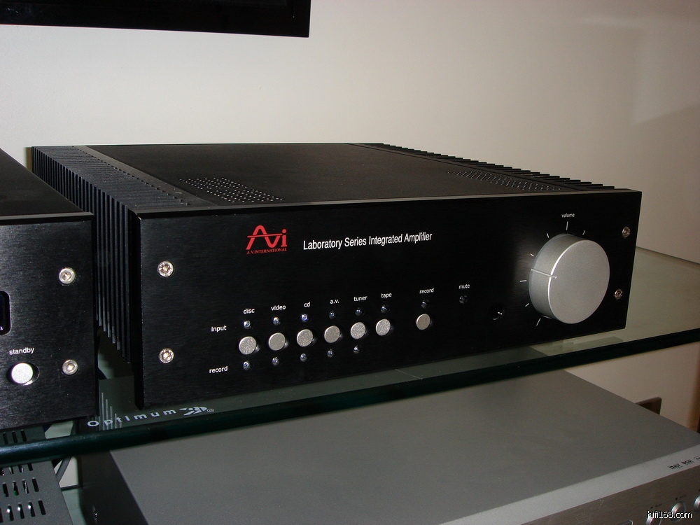

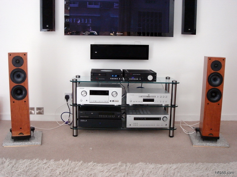

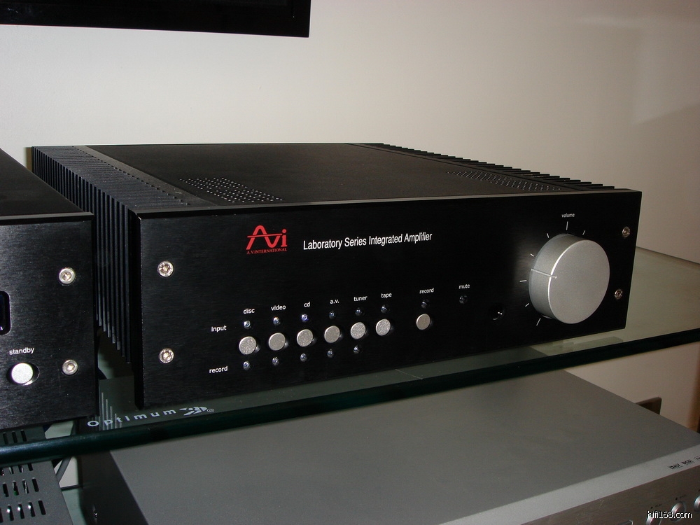

AVI一套西装和Spendor S5e
第二排是Marantz SR7001和SA7001
最下面一排是Arcam的DV137和AVR350
jpg(2007/9/13 2:34:19 上传)

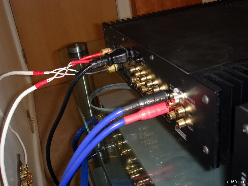

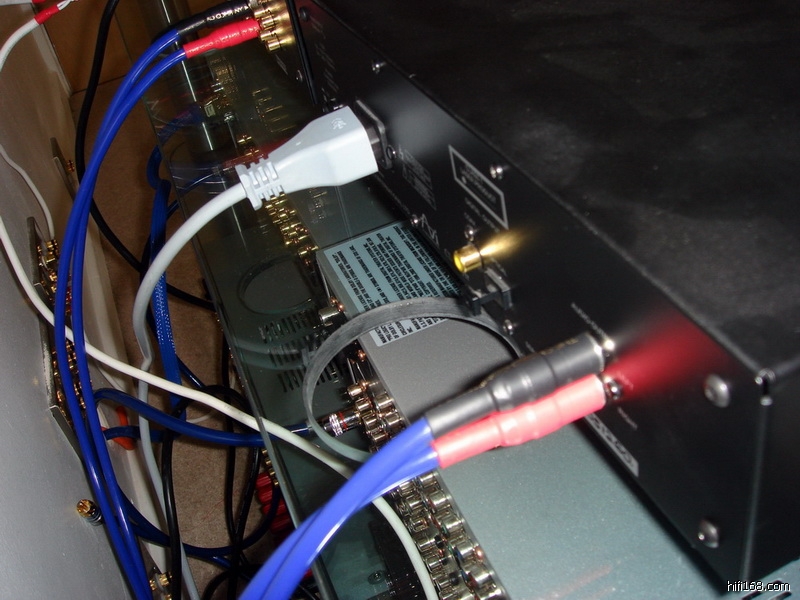

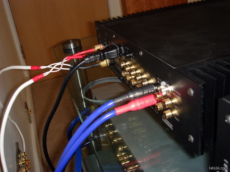

背面的图片
jpg(2007/9/13 2:36:15 上传)
